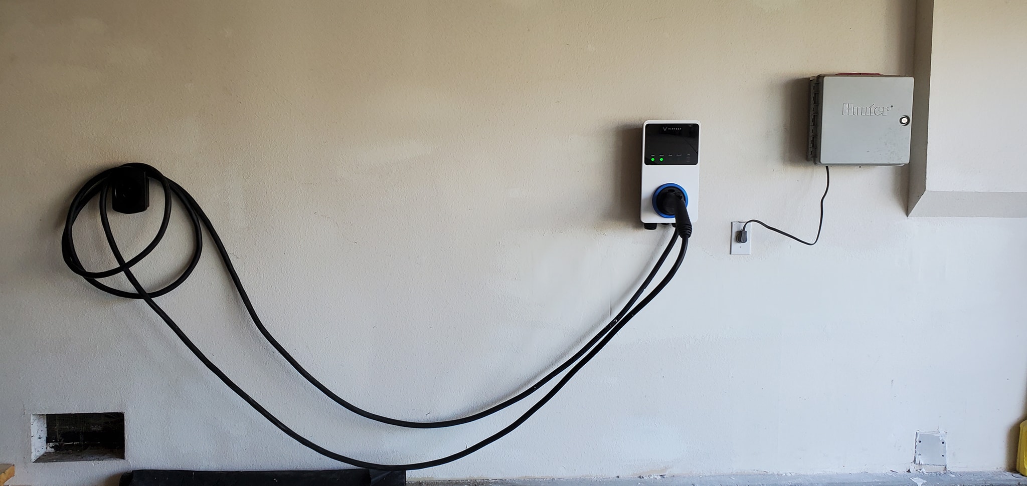

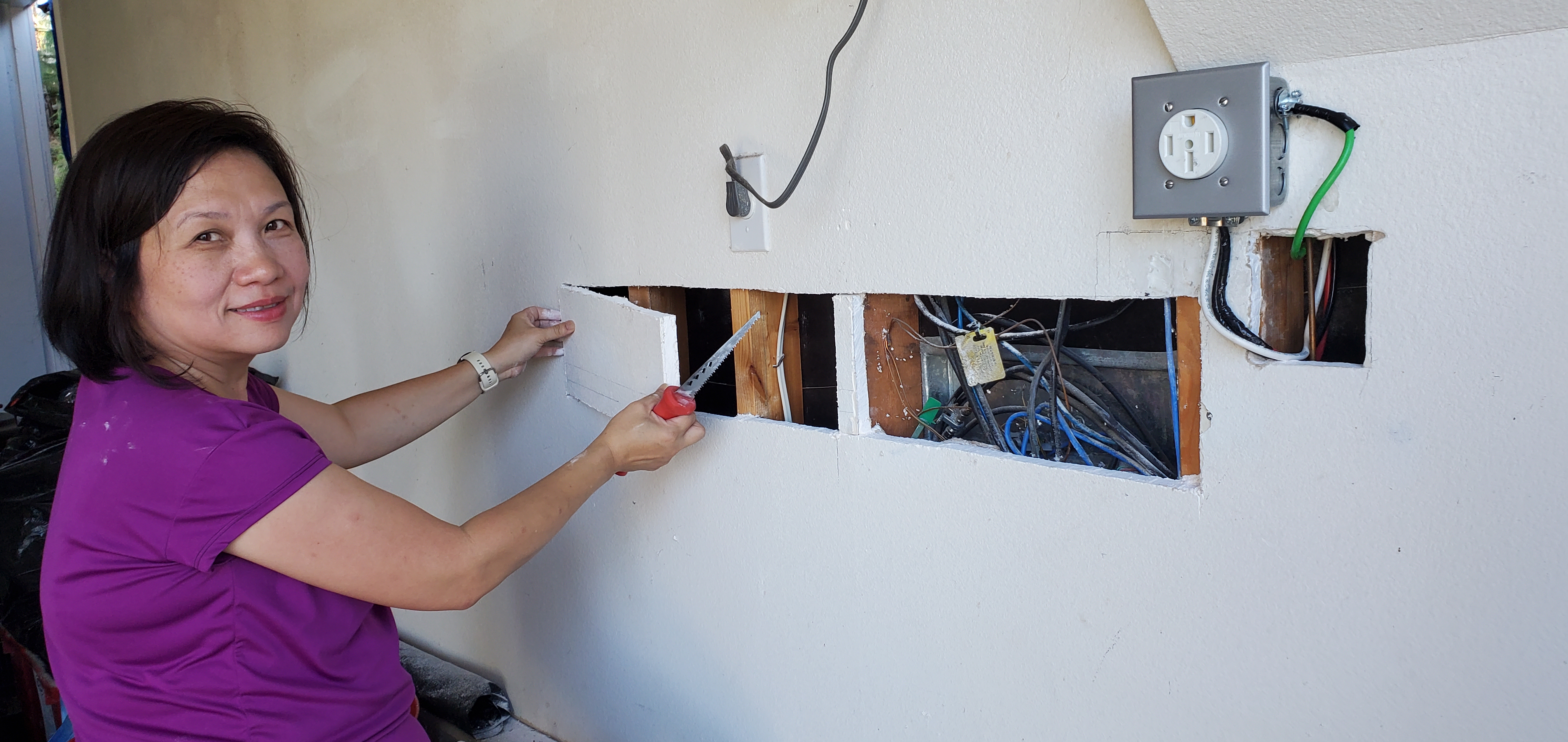

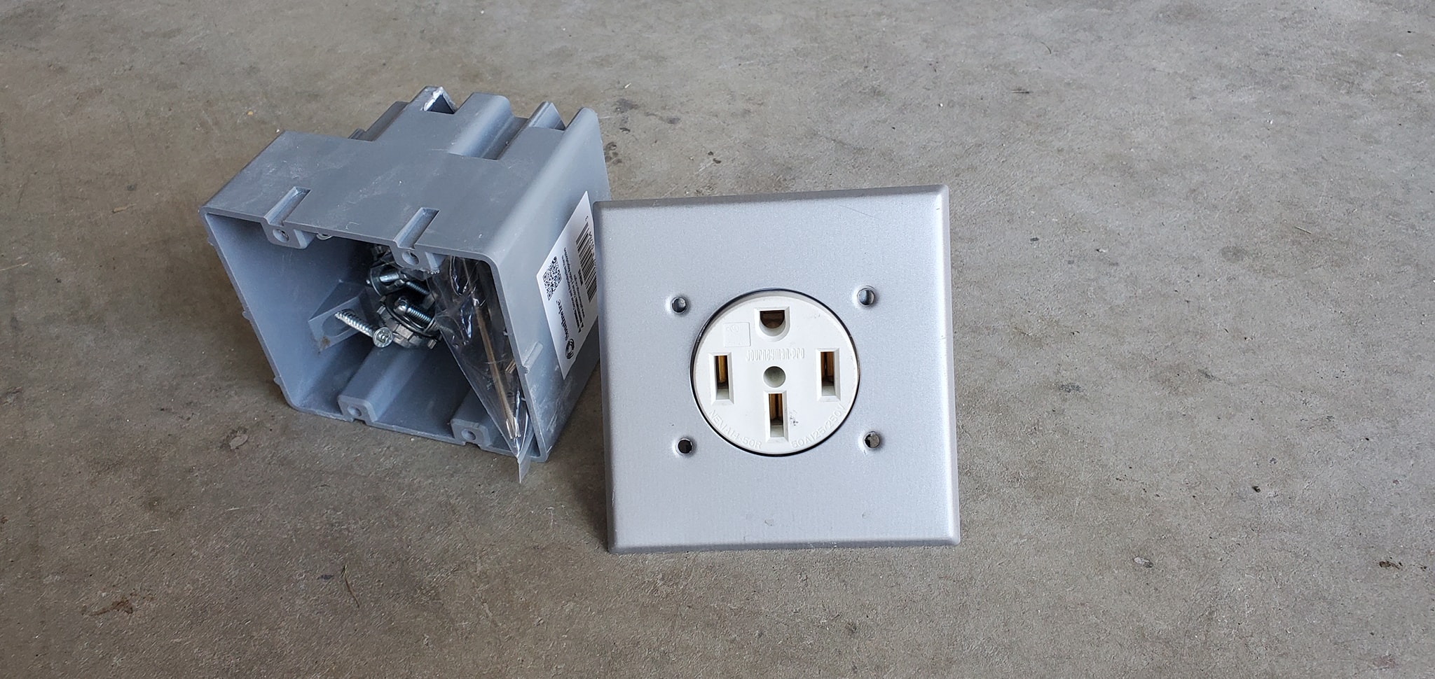

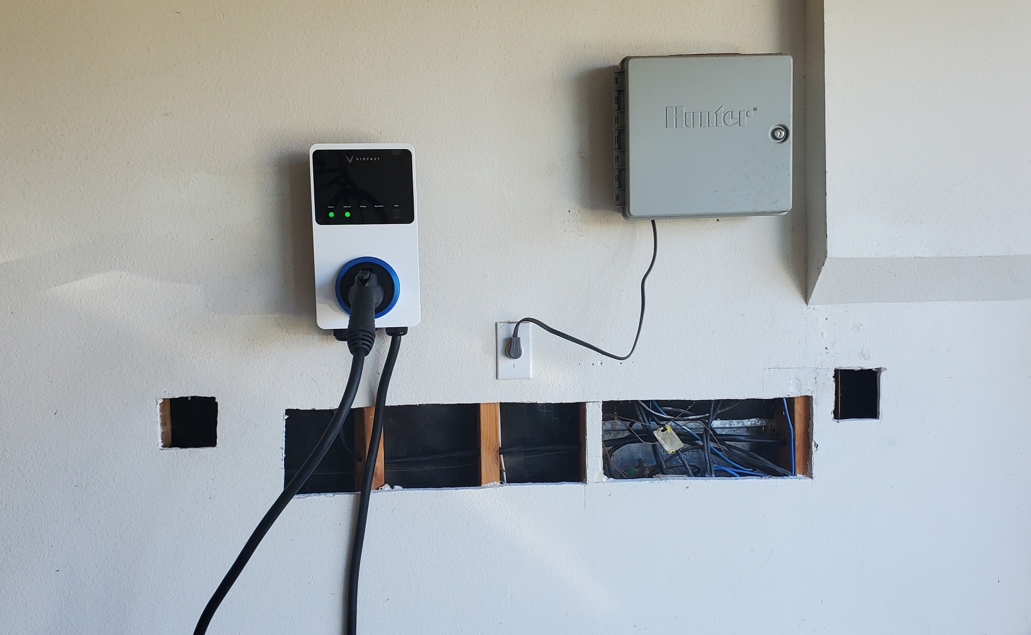

    When we pick up the VF8 Plus, VinFast gave us a Free Level 2 Home Charger and I bought the parts and installed it myself. It depends on what charger you buy. The Level 2 VinFast Home Charger is hardwired and it connects directly to the circuit breaker panel. There is no need for a NEMA 14-50 outlet. The home charger is capable of charging up to 48 amps or 11.5 kW. I went to Home Depot and bought a 60 amp breaker and a 6/3 WG Romex wire and installed in the circuit breaker panel. If the home charger is from a different company, and not hardwired, you have to buy the NEMA 14-50 receptacle outlet and only charges up to 40 amps or 9.6 kW. Initially, I bought the outlet and I did not know that VinFast gave us a home charger for free. I still have the NEMA 14-50 and if anyone wants it, I would be happy to give it to you. The charger is connect to the solar panel and saves me money. At my company, I paid $20/month to get unlimited charging access. The VinFast Level 2 Home Charger charges from 25% to 90% in about 6 hours. Additionally, VinFast gave me a promotion of a one year free charging subscription, for any participating charging station.
