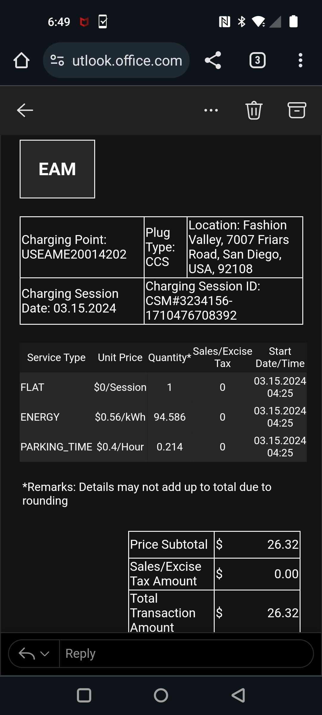

        I was joking at at EA and the app does indeed dbl the kilowatts given from what is displayed on station. However I do have free charging but for ones that do not take pick of the EA station for price and then look at what it is showing on app receipt if different contact customer service and provide the pics they will refund the difference if price is different. But I think it’s just a glitch on the app to EA communications.
  • Scott Davis
    03/15/2024 at 06:51
    I just went to EA last night and station had 47kw consumption the app showed double so it is probably the app glitch.
  • Ethan Castillo
    03/24/2024 at 20:28
    This is what I got charged from 30 to 90%… I would recommend trying to charge at home. If you can and have access utilize the dryer outlet, you’ll fully charge for 5hours and it would only be about $10-$15 (@0.19/kwh).
