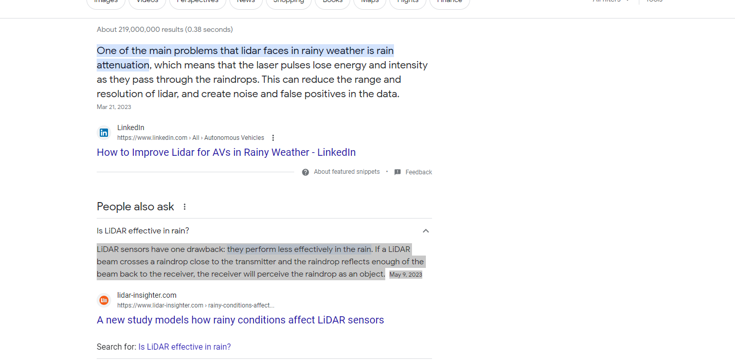

    • Phuong Pham
      03/07/2024 at 10:06
      Front collision work depends on the lidar in front of the vehicle. The lidar will not work reliably when there is heavy rain due to the reflection of the light can be impact by the water. Therefore, it is safer to let the user to handle such situation.
      What is lidar? Learn How Lidar Works | Velodyne Lidar
